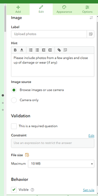

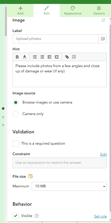

In Survey123 Web Designer I am trying to enable an image question to allow multiple images.
However, my published Web Designer survey will only allow one photo to be uploaded/captured.

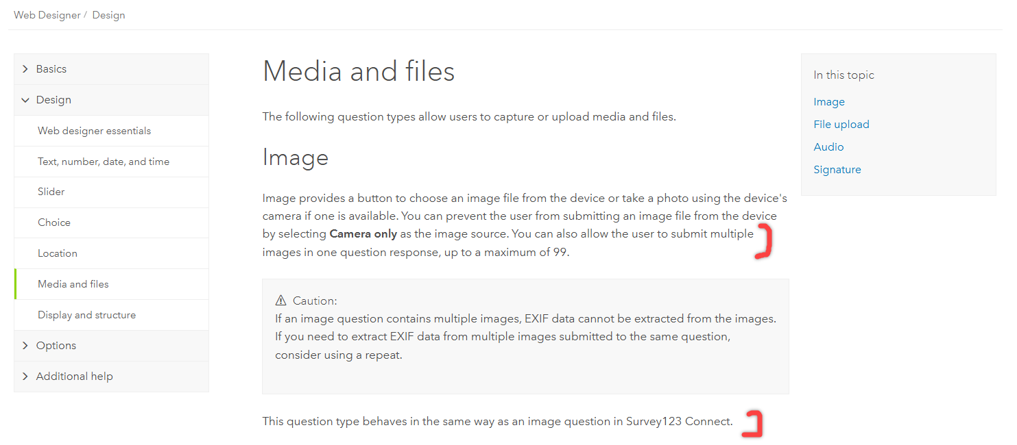

According to the documentation, this is supposed to be possible?
Could someone please show me how to do it?
https://doc.arcgis.com/en/survey123/browser/create-surveys/mediafiles.htm
In Web Designer you can set the capture type (camera or upload), and set the size, but there is no setting that will enable multiple images.
Below is a screenshot of the image question in my form - there are no contraints or behaviours applied to it.
Thanking you in advance.

Hello,
To enable multiple image upload using the web designer, edit the 'constraint' parameter to "count is at least" and set the 'value' to 1. Of course you can change this to a minimum or maximum number as needed. Test this is working as expected from the survey 'preview'.

acarmody
@SarahSinghNZ thank you so much, works perfectly!
