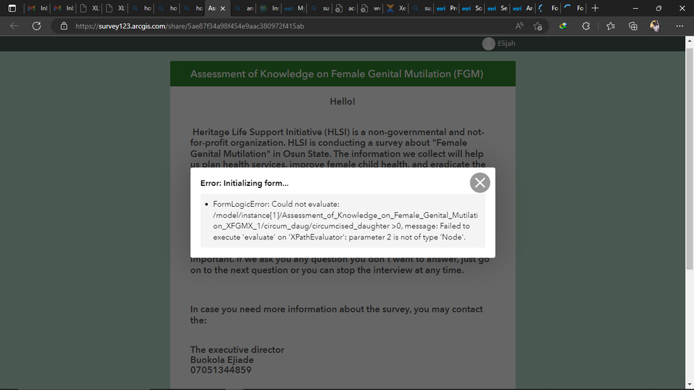

Hello @IsmaelChivite, I have similar challenge as @alyssajhnsn. What is the update on the loggeded defect "BUG-000153480"? .
Initlally, I  thought  the error occurred because of long field names, but the field names were less that 31 characters. I have reduced the length of name fields and also explicitly converted calculate question type to integer for use in repeat_count the error still persist.
In my case, adding the repeat question, which has a repeat_count and relevant expression, prevents other prior questions from being displayed. I removed the repeat group and discovered they displayed well. So does it imply that, at the moment, I can't use dynamic repeat_count and relevant expression in our survey? I would appreciate a workaround.  This is the link to the survey FGM
Thanks
Elijah.
