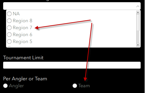

I am having a layout issue looking for some thoughts....
I want a black background with white text.  Simple enough right....nope.

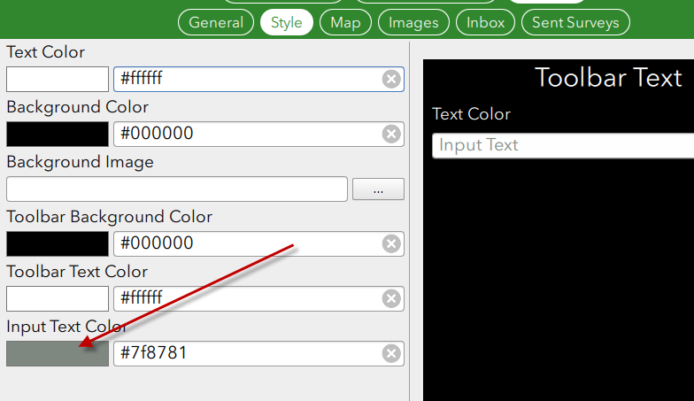

The problem I am facing is that when I change the "Input Text Color" it effects:
  1. The text in the drop down
  2. The text for the radio buttons
So with a Black background and a White Drop down background:
  1. If I made the text black it does not show up in the Radio Buttons
  2. If I make the text white if does not show up in the Drop Down box
As you can see in my example it is gray but extremely hard to see in the sunlight
Is there a way to:
  1. Change the color of the text specifically in the Drop Down box
  2. Change the color of the drop down background
  3. Change the color of the Radio Button text specifically
