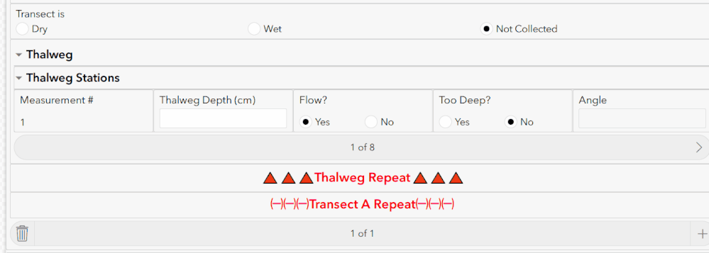

Today in 3.12 I am seeing the fields hidden using the visible column are not turning off required.  Early betas this happened but it was fixed.  It sticks the form on the user and they cannot go forward.
Did this bug come back?  Seeing in connect and app.
So far it seems to just stop on a random field in the hidden group, if I remove that one it ignores the rest somehow.  Plus there are some in front of it somehow skipping.  I think it may be the first in a nested repeat or something. Very strange.
