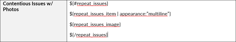

I am experiencing poor formatting/space utilization in my feature reports with repeats, especially repeat photos.

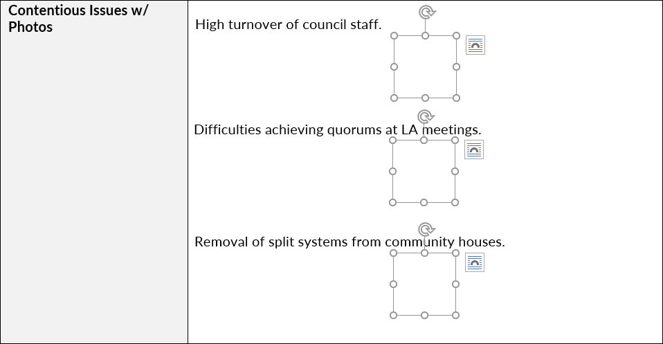

As you can see from the screenshot below there is a lot of space wasted for photos that don't exist.
Is it possible for the feature report to be built in such a way where space is not wasted when there is no data entered into the survey itself?
The below screenshot is how the feature report is built to try take up the least amount of space between each answer of contentious issues (repeat) and contentious issue photos (also a repeat).
Below is the same content above but at a readable font size.
Any help would be greatly appreciated.
IsmaelChivite
Esri Notable Contributor
Hi. I think conditional statements could help here. Feature report templates—ArcGIS Survey123 | Documentation
${if photo1}${photo1}${/}
JamesBailey
It worked, thank you Ismael Chivite
