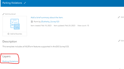

Another thing to check would be the item details page of the survey form item in your content. On the item details page of the survey form item there will be a Layers section and will link to the feature service the survey is pointing to:

janderson_ksninc
ZacharySutherby
Hello @janderson_ksninc
Since there was a submission_url present in the XLSForm Survey123 Connect won't create a feature service on publish and will use the feature service with item ID 5f1ca2716f994b9c9788a09b5ef7ff2a as the service to submit data to. Please see this documentation for more information: https://doc.arcgis.com/en/survey123/desktop/create-surveys/survey123withexistingfeatureservices.htm
