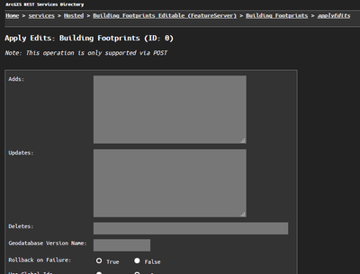

Hm. I see the request being sent to the service URL, but when I look at it, I don't see the edit capability.
Normally, going to ...FeatureServer/layerIndex/applyEdits brings you to something like this:
I would guess then that the problem is with the feature service, not the survey itself. Can you double-check the editing settings on the fieldworker view?

Thank you very much for the tip, I must have disabled the editing, I have enabled it and now it works! Thank you for the help! 🙂
