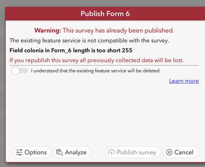

Did they update the error message? I normally see this when a string length is exceeded:
Send Error. This survey could not be sent due to the following error: Database Error
Still a database error though.
I don't see anything odd with the XLSX, and it submits fine in a raw form. It would make sense if the data you were pulling exceeded the 255 default character length. You could try changing bind::esri:fieldLength for two of the pulldata fields to be, for example, 1000 (and just temporarily delete the other pulldata calculates). Be aware that that type of change will give you this warning:

@abureaux Thank you so much!
It was the first pulldata the one that gets the info form the https. I updated the lenght to 25,000 and that fixed the error.
