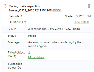

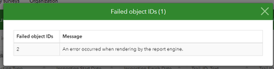

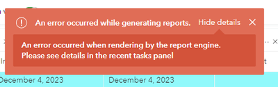

I am trying to generate a report using a custom template but keep getting the below errors. Unfortunately, I don't get any more information on where the problem lies or what Failed Object ID 2 is. Does anyone have an idea of where I should start?
DuncanG
After working through each line of the template I have actually resolved this issue now.
I had a number of If statements that it did not like, after re-phrasing them it went through ok:
This :
To ${if Inspection_Type == “Off Road – Traffic Free Cycling Trail Registration Inspection”} become${/}${if Inspection_Type == “Mountain Biking Trail Registration Inspection”}become${/}${if Inspection_Type == “On Road Cycling Trail Registration Inspection”}become${/}${ if Inspection_Type == “Off Road – Traffic Free Cycling Trail Inspection”}remain${/}${ if Inspection_Type == “Mountain Biking Trail Inspection”}remain${/}${ if Inspection_Type == “On Road Cycling Trail Inspection”}remain${/} listed on the National Trails Register, the ${if Management_Result == “Does Not Meet Requirements”}management${if (Management_Result == “Does Not Meet Requirements”) && Infrastructure_Result == “No”} & ${/}${if Infrastructure_Result == “No”}${if Sum_Safety_Issues >0}safety and/or ${/}significant${/} issues identified in this report need to be addressed.
Changed to this:
To ${if Inspection_Type | selected:“Off Road Registration”} become${/}${if Inspection_Type | selected:“Mountain Biking Registration”}become${/}${if Inspection_Type | selected:“On Road Registration”}become${/}${ if Inspection_Type |selected:“Off Road Inspection”}remain${/}${ if Inspection_Type | selected:“Mountain Biking Inspection”}remain${/}${ if Inspection_Type | selected:“On Road Inspection”}remain${/} listed on the National Trails Register, the ${if Management_Result == “Does Not Meet Requirements”}management${if Management_Result == “Does Not Meet Requirements” && Infrastructure_Result == “No”} & ${/}${/}${if Infrastructure_Result == “No”}${if Sum_Safety_Issues >0}safety and/or ${/}significant${/} issues identified in this report need to be addressed.
