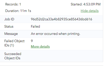

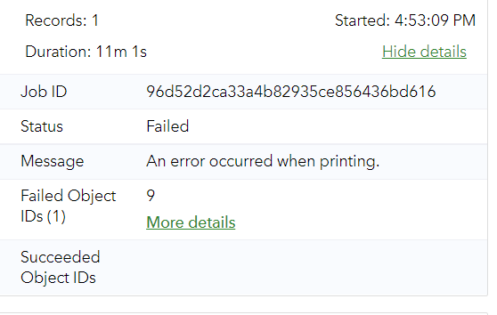

I'm trying to generate a report from a template but I keep getting an error that an error occurred when printing and I'm not trying to print it. I checked what object ID 9 was but I can't figure out why I'm getting this error (or how to find what part of the survey object ID 9 is and what to do about it). I did an almost identical survey and it worked fine. The only difference was there were about 50 attachments (pictures) to this survey and the one that's working had like 30.

Hi @EPAHUNT1 ,
It seems that you are trying to generate a report where the duration is more than 10min which is the limit time for single session.
you can see the comment of @Ruth_JiatengXu  in the below link:
https://community.esri.com/t5/arcgis-survey123-questions/an-error-occurred-when-printing/m-p/1006114...

Hi @EPAHUNT1 ,
We had updated the Survey123 website on 7/29 PDT with a security update and performance improvements to the report service.
Your report workflow should be able to run now. If you still observe any issues, please let us know.
