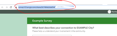

RachelPies
I was having the same issue, but just got around it.
Open the survey link so you are looking at the survey in your webbrowser. Use the link copied from the open survey instead of the link provided by Survey123.
I have no idea why... but the link from the survey itself resolved my problems.
