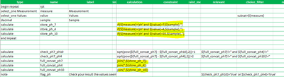

js80540
I found two work arounds, and implemented one. But please let me know if there is something easier!
One solution is using concat in the repeat to create a json like structure to store all the data. Then using join outside of the repeat to make a list of json like object contain, each item containing the data for one repeat. Which in turn can be parsed using a custom javascript function... Messy and dirty but it works.
The second solution I have found, which only works because I have only three values to store is using join. Using an if in my calculation within the repeat, I insure that only one value will be returned for all the repeats iteration. The join outside of the repeat will then only have one value to join and will have stored the data I need. Here is an image showing the mess :
Not pretty but it works, I am sure there are better way to do this so let me know 😄
