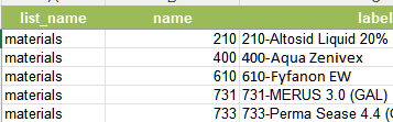

I need to export the table with the domain label, not the coded value in the choice tab of the form.
Every time we export, we get the code, which is useless when reading the table as an end user.

You can make the name and label the same... or you could also capture the label in a separate question.
see ":jr:choice-name(choice, 'question')" section:
