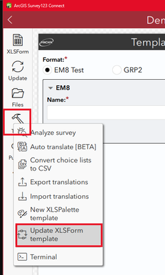

The newer Connect apps can update XLSX for you. Tools > Update XLSForm template
