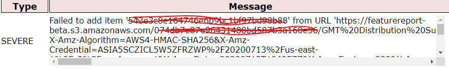

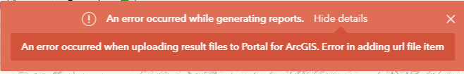

The supportsPagination error is solved with the beta but I am facing a new error as shown in below figure
We have ArcGIS Enterprise 10.8
Facing public
Once I checked the Logs in \portaladmin i copied the URL and browsed it then the report downloaded successfully!
please help

Hi Hussam Rabea‌,
Thanks for the feedback.
I saw there is a similar issue here https://community.esri.com/message/934689-an-error-while-generating-feature-report-portal-for-arcgis , if this is the same problem, maybe we can continue discussion there so any other user who has the same issue has more chance to see it.
Hussam_AlJabri
Yes it is the same. will meet you there.
