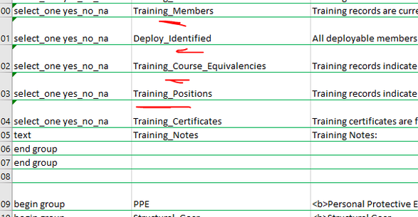

DougBrowning
MVP Esteemed Contributor
Ok I think you have a secret newline in excel.  Happens to me on the reg.
Turn on word wrap for each column then look to see if anything goes to a double size row.  That is your clue to find them.  This can happen from a copy paste and would explain this.
CEMPAdminPOC
So I am better to turn off wrap text in the form?
DougBrowning
Sorry I mean turn it on.  Look for any double lines.  This means a \n got slipped in there.  Delete from the end and you will see the double line disappear.  Once fixed you can flip it back.  But you got to get those outta there.  You will see them.
CEMPAdminPOC
Guess I didn't hide any lines either.
DougBrowning
I found them on
Equipment_Prov_Guidelines
Maintenance_Power_Equip
Training_Records
Training_Members
There are actually a ton.  This sheet is a bit of a mess.  You need to be careful with the pasting.
I suggest rebuilding this form by moving to a new template.  I have a write up somewhere.  But basically start a new form in connect.  Move each column from the old to the new making sure to Paste Values!  Then again look for the extra lines above I guess since that will not fix it.
Then just rename and replace the xlxs in the file system on the old form and it will take it.
Good luck
