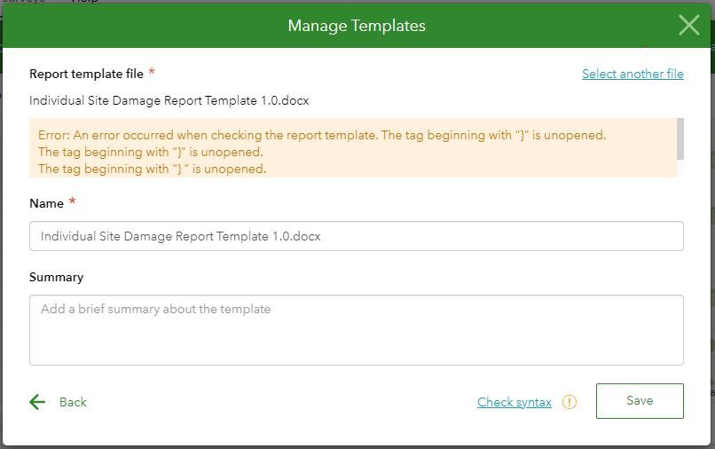

Error: An error occurred when checking the report template. The tag beginning with "}" is unopened.

Hi I have just finished my template for a new survey and it is giving me this error message (see photo). Has anyone ever ran into this before? any direction is appreciated.

More times than I can shake a stick at.
You need to do some troubleshooting on your end (this is a common error). Basically, there is something wrong with you start and/or end "tags". Check your document for ${name} and ${/}. You could be missing a tag, you could have a poorly formatted tag (e.g., $(/}), or could have too many tags.
If you are really lost and/or the document is massive, I find the easiest solution is to play 20-questions. Delete half of the document, and try parsing. Keep add or removing halves until you get the document to parse. Then add things back in until it breaks again.
EDIT: Had a quick scan of your document by doing a mass find-replace, and looks like tags are correct. Could be a formatting issue where the parsing system doesn't understand the margins. This is more likely to affect repeats, so you could try deleting out all the repeats and see if it works.
Also, I know the "multiline" appearance doesn't like being in tables and can cause an error, but I have no idea how it interacts with multiple margins. May also be worth focusing on those fields.

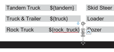

Not sure if this is the case, but I searched through the doc and found 52 of { and 54 of }, I found only one visible double located here:
There's a chance that due to the duplication it may be causing some issue, I had not been successful in finding the other } though. Hope that helps!

Yep. That's definitely it. I didn't see the duplicate before on my screen... until I started poking at the elements. There is some funky things going on here:
That double you found is it's own element!
And there are more overlain elements on top of that:
This is very likely the cause of the issue. I'd highly recommend rejigging the document to use more "plain text" and tables.

Great eye! I moved the curly bracket but not had seen the overlapping elements. Definitely recommend what you mentioned, as long as the brackets are even to some extent, the Survey should be able to run through.
