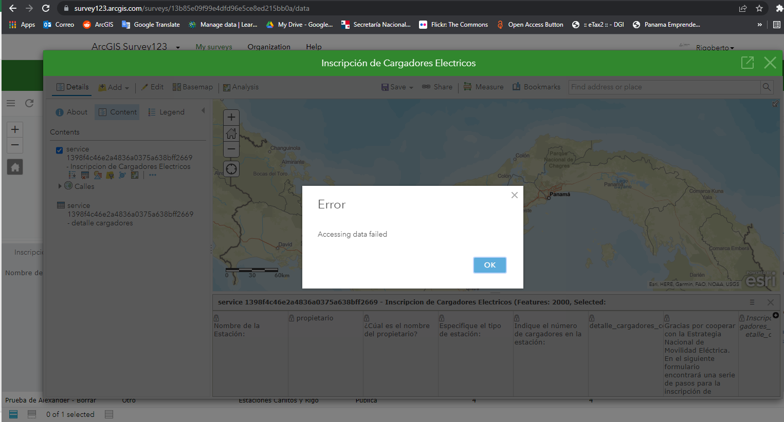

When in the data section of a survey, and click on "open in map viewer" data is not displayed and when clicking on attributes table the following appears. Only 1 record is recorded but I think it should not influence this, furthermore settings of hosted feature layer is on "allow export data".

One of the changes that was made with Survey123 3.14 is feature services created with surveys on publish (unless editing sent surveys or the Inbox is enabled) the service won't have query enabled. This will cause the issue that you are seeing as the web map is not able to query the feature service.
In the feature service settings if you enable update that will enable query on the feature service and should resolve the issue.
