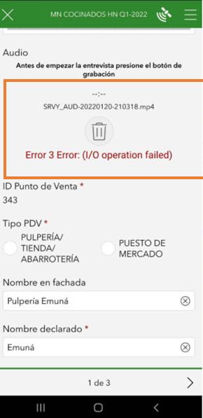

Hello. I wonder if anyone had come across the following error?
Context is customer recorded audio, audio stopped and part of the rest of the survey was filled out, the after that, they switched to another survey and then they also switched to a different application. Then, when coming back to the first survey the audio was missing with the error 'Error 3 Error: (I/O operation failed) '.
We had attempted to replicate the issue again for the ESRI support ticket but no luck with that.
If anyone has a comment on this, we appreciate.

DanielMurillo
Hello @Anonymous User .
They say this is an Android 11 Samsung A10s.
It only happened once and we have not been able to replicate the same error, however as you are stating if I do not stop the recording and save it on the drafts folder it does not maintain the recording. I just tried that and lost the recording i had made.
The recording was not also found on the Attachments folder.
Thanks for the guidance.
