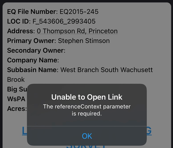

Error:
I did check and the Survey123 data submits properly. I am returned to the proper map in Field Maps, but see this error each time.
Does anyone have advice on how to resolve this issue?
