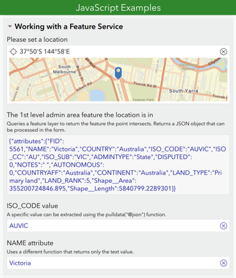

To get started, I recommend having a look at the 'JavaScript' sample in Survey123 Connect. It contains a group named "Working with a Feature Service" with an example. The example uses World Admin Divisions as the polygon layer (the URL for this can be changed to your Station Number polygon feature layer) and then shows a few different pulldata() functions for returning different components of the response. You will be able to easily adapt this to suit your feature layer.

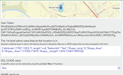

Hi @BrettStokes
As mentioned in my comment below, I encountered an issue with the token. I have discovered that if I pass the token that gets generated when I access the feature service, I can get the code to work. I imagine this token is unique to me or gets regenerated so hard coding the token isn't a solution ... or is it? Here's screenshot of where I am at. By the way, I created a test polygon at my current location for convenience while testing.

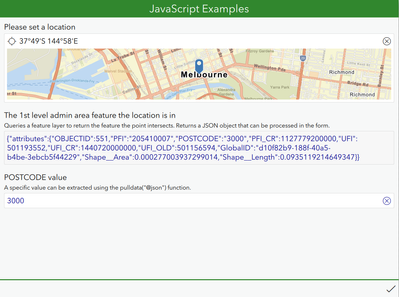

I've attached a XLSForm example of the edited 'Javascript' sample that is pointed to a publicly shared post code polygon feature layer (https://services1.arcgis.com/e7dVfn25KpfE6dDd/arcgis/rest/services/Post_codes/FeatureServer/0). It uses the same javascript function as the sample, so you should be able to create a new survey based on the .xlsx file (just copy the 'url_requests.js' file to the 'scripts' folder). Note that the feature layer only contains post codes from the state of Victoria, Australia. You will need to place a point somewhere in Victoria to get a valid response:
