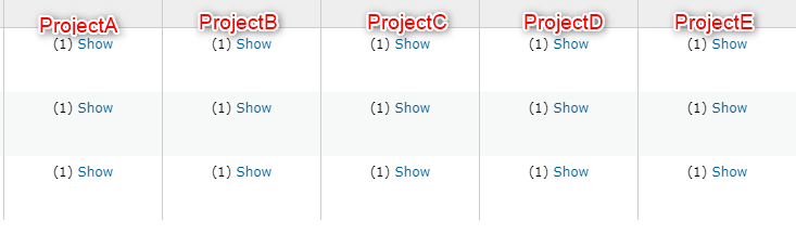

Hello all,
One of my survey seems showing unexpected behavior.
In the survey, users will choose project type and then relevant questions will be shown and saved under a related table. So if I choose Project B in my first survey and work on some questions, I expect to see  '(0)' other than Project B column as no related tables are created for Project A, C, D and E. However, as shown the image below, all of them are filled with (1). If I click (1) show under ProjectB, there are questions and answers I typed in. But if I open the rest, they are all empty record.
I tried multiple entries, and no matter I choose, there are empty row created in every related table.
This is schema preview. User will choose only 1 project in each survey.

Hi. Set the appearance of your repeat to minimal, and now empty records will be created. By default, when adding a new repeat to your form, a first record is always created so users can see questions within the repeat. You can overwrite this behavior by changing the appearance to minimal.  A record will only be created if the user explicitly opens the repeat.
JayH
Hi Ismael,
Setting the appearance minimal still created empty row for the related project tables that are not supposed be used. I solved the issue by locating each repeat under its own group, and then applied relevant condition at the group level.
