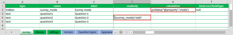

We use pulldata("@property","mode") = 'edit' in the readonly column for several fields (DateofEvent, TimeofEvent, SupervisorList, and CheckOne), and these fields should be read-only when the survey is opened in Edit Mode. However, when the survey is launched from Experience Builder, those fields remain editable even though the record is clearly being opened in Edit Mode. Has anyone else noticed pulldata("@property","mode") not behaving as expected when Survey123 is opened through Experience Builder? 

Did you try the trick from the solution to use a field?
RoshanPalikhe1
I tried with this solution as well but didn't worked.
