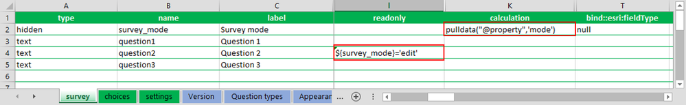

I am not able to place ${survey_mode} = 'edit' into the readonly field, it fails validation restrictions on the cell, is there another method to set a field to edit just once?

I was not aware that pulldata("@property", 'mode') was not working in the readonly column when the record is opened from the Inbox. I do not think this is expected. @ZacharySutherby  Thoughts?  This is probably worth documenting as a BUG via Tech Support.
As a workaround, you may want to create a calculate question to get the mode, and then reference that value from the readonly column.  Do not forget to set the esriFieldType column to null on the calculate to avoid having that output go into your survey layer.
