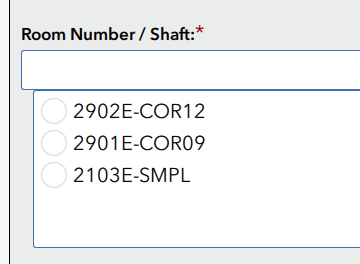

For example, I have a dropdown where the user selects a room:
Then that choice dynamically selects a room image for the annotate question:
