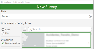

Raul
If you're able to access the original data, I'd make a copy of that onto another hosted feature layer, then configure a new survey to write data to that new layer via submission url.
(Create new survey from Feature Service)
