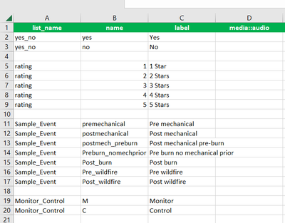

Hello,
I am new to Survey123 using Survey123 Connect. I have a number field (Single) where it is only appropriate to enter data in increments of 0.5. Instead of entering a number, I would like a drop down menu to appear with the following options: 0.5, 1.0, 2.0, 2.5, 3.0, 3.5, 4.0, 4.5, 5.0, 5.5, 6.
Is it possible to do this with a number field? The field data type can not be changed at this time.
Please recommend comprehensive resources, I'm new to this 🙂
Andrew
