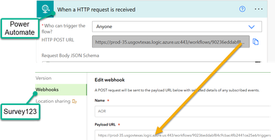

Considering my limitations not having access to “Survey connector”, I was wondering if I can use a flow with “When A HTTP request is received” to accomplish my goal.
I appreciate any help figuring out this flow. Thank you
