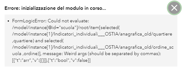

I have configured and published a survey using Survey123 Connect in an ArcGIS Enterprise environment. The survey includes a repeat and uses the inbox mode.
When using the app, everything works fine, but when I open the survey from the web (https://survey123.arcgis.com/), I get the error shown in the attached screenshot—both when I try to open the survey and when I try to edit a record.
What is this type of error caused by? Is there a mistake in the logic or syntax of the XLSForm? Could it be related to the use of repeats and/or the inbox? Or are there other possible causes?

Would you be able to attach the XLS forum? It may be an issue with the formatting as you've suggested, from the screenshot it may be a misplaced comma or similar.

selected(${quartiere},quartiere) and selected(${ordine_scuola},ordine)
You forgot to put quotations around the text... I think this could be causing the issue.

I think the syntax of the selected formula is correct, the text refers to a column in the choices sheet not to a specific string value

It has something to do with your scuola choice list from line 44.  Your "scuola" list has a bunch of special characters (/,.,',(,)) etc in it, not sure if that has anything to do with it, but if you delete everything in that list from line 397 down, your form published without the error, if you add those back in the error returns, not sure what the issue is with that portion of the list, but it is something in there that is braking it.
the syntax for the choice filter appears to be correct.

To narrow it further has something to do with the filter "Ostia" in the "quartiere" column in the scuola list.
Neal_t_k
to narrow it further  remove the default of "Ostia" from this question.
I have no idea why that is causing the issue, but if you have a default or a calculation it throws the error, but without out them it works in the web app.

I tried removing the default value from line 7 as you suggested, and indeed, this way I no longer get the error message when launching the survey from the web.
However, the error still appears when I try (still from the web) to edit a record.

There is still something off with that list, no matter what I did I couldn't get it to populate on the web app. My best suggestion is to simplify your form a lot (i.e. without any choice filters), publish it make sure everything works, and the start building back in complexity publishing periodically to test on the web app.   I don't speak Italian and I don't know if Italian keywords are the same as English keywords but cleaning those up was suggested by @DougBrowning in a previous post: https://community.esri.com/t5/arcgis-survey123-questions/form-logic-error-uploading-from-connect-to-...
