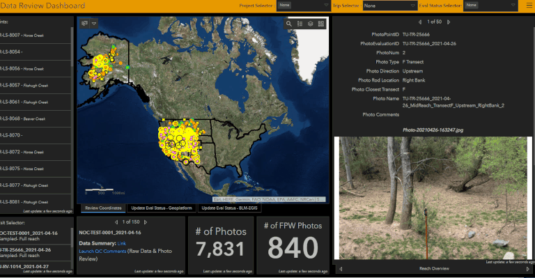

What we do is leave the photos in the service until the end of the season then we download all of them and put them in our permanent spot on our web server.  I think this does work out better as the service can get too big and we take down the field season service.  During the year we simply link to them where they are or use things like Ops Dashboard where we have a full photo review dashboard.
AGOL is designed to use the photos in place which works in many applications.  Sounds like your users want them the old school way.  That is understandable but it will be some manual work to download on the regular.  I suggest at least testing out some more modern ways to view and use the photos.

this is our photo review dashboard
