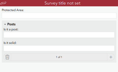

abureaux
MVP Frequent Contributor
"...points captured ... can range from 5-500 or more".
So you'll need a repeat.
"Each ... points captured has approximately 20 fields ..."
All good there
"...For all these points, one field input remains the same ..." and "...one fence survey will be conducted at a time"
That all seems easy enough... have you tried this?
Placing "Protected Areas" outside a repeat means you can use it for all repeat items. You can even pull it into the repeat if you'd like (either via a calculate in the survey, or in the Feature Report after the fact).
EmmaErickson
Hello abureaux,
I appreciate your reply - thank you for the info. I worried that a repeat may glitch out with the number of points that are being captured around an individual protected area. If it's unlikely that that is going to cause issues, I think we should trial the repeat and see how we go.
Thanks again 🙂
Ems
abureaux
It sounds like you have a very small/simple survey, so a few hundred shouldn't be an issue.
Curious, but if not a repeat, how were you planning on collecting those fields? That seems like a wide margin to have hard-coded in!
