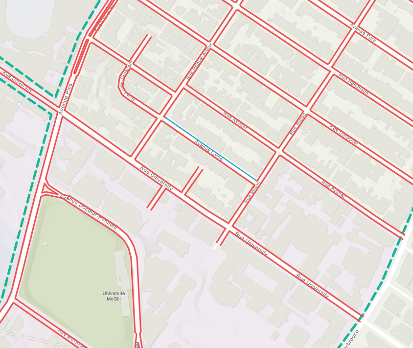

I have this AGOL map that uses different colors based on surveys and created a symbology which works fine in the web version of the map.
Notice the blue line in the following screenshot:

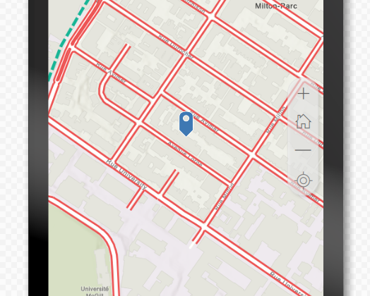

Then I linked this map in Survey123 Connect and added it's ID reference under body::esri:style for a geopoint question. This is what renders in the app (no blue line):
Any reason why the map symbology does not follow?

Question on semantics. Is that a "Blue line", or is it a "selected feature"?
mikaël
great question!
there is no selection. I have an arcade expression which defines symbology categories and then those categories are styled differently.
Edit: the labels, which are based on the same rules (yet they are filters, not an arcade expression), do work.
Web map viewer:
Survey123:
