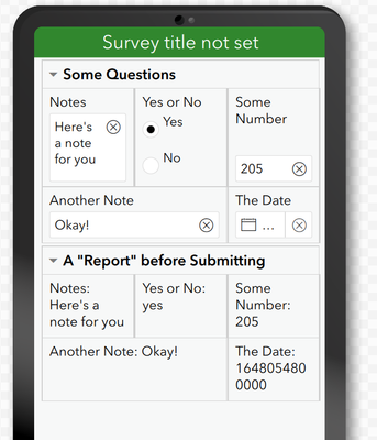

I'm new to ArcGIS & Survey123, but I am a software engineer by trade. I have not been able to locate the answer to my question. I'm trying to figure out if there is a way to display a temporary "report" of the answers to my survey PRIOR to the user clicking submit. In the field, my user wants to be able to verify that he has input all of his data correctly before actually submitting it, but that would mean he needs to see the data somehow, formatted correctly.

If you use Survey123 Connect, you can create placeholder questions that reference answers elsewhere in the form. You can download it here, if you don't have it yet: https://www.esri.com/en-us/arcgis/products/arcgis-survey123/resources
In the XLS Form, you just add new questions and then use ${fieldname} to pipe in answers from other questions. Here's what the spreadsheet might look like.
typenamelabel
begin groupg1Some Questions
textnotesNotes
select_one yes_noyes_noYes or No
integersome_numberSome Number
textnotes2Another Note
datethedateThe Date
end group
begin groupg2A "Report" before Submitting
noten1Notes: ${notes}
noten2Yes or No: ${yes_no}
noten3Some Number: ${some_number}
noten4Another Note: ${notes2}
noten5The Date: ${thedate}
end group
And here's what the form looks like, filled out. The "report" section could as easily be on its own page of the survey, as a sort of "preview your response" page that could be viewed separately.
- Josh Carlson
Kendall County GIS

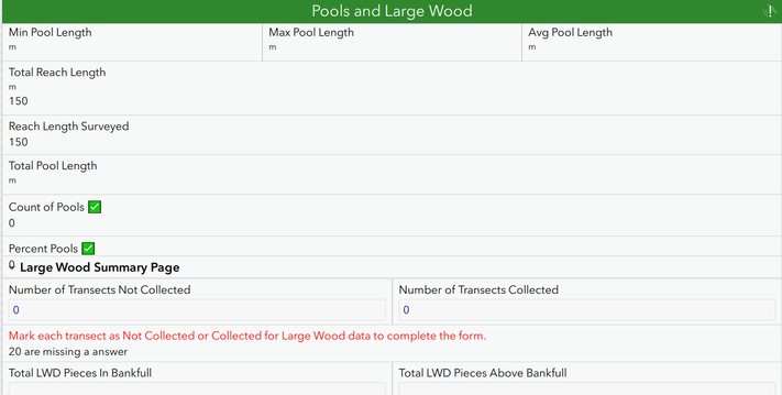

DougBrowning
MVP Esteemed Contributor
I use summary pages with grids at the end of the form.  Here are a few samples.   I use red warning or emojis to give warnings.  https://community.esri.com/t5/arcgis-survey123-questions/create-a-summary-page-within-my-survey/m-p/...
There are more posts also just search around of you like the idea.

Yes we make summary pages for most of our forms.  Using grid and groups works out nice.  You just use sum, join, max, min, etc and it works ok.  Red call outs in potential bad answers also.
