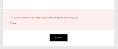

m3
If anyone is looking to disable their submit button, the accepted solution sort of gives you what you are looking for but it's more complicated than that.
In my case I want to disable the button if they select "Private" in a question named "public_or_private"
I added a text row to Connect that contains
Label:   (if you don't want a visible label)
Required: yes
Readonly: yes
Calculation:
if(selected(${public_or_private}, 'Private'),${public_or_private},'​')
Plain english calculation translates to:
if selected is "Private" return what it says - which happens to be "Private", otherwise return what's between the '' at the end
In my case what's in the '' at the end happens to be a unicode zero width space because a space didn't work, you can put a - or * or . or whatever you like in there, I just need my submit to not work when it's "Private" and don't want it to say anything in the area otherwise
Constraint:
${public_or_private} != 'Private'
constraint_message::default
The submit button is disabled because the property owner type is:
Then the rest of the survey has
relevant:
except one field that I want show when the select "Private"
