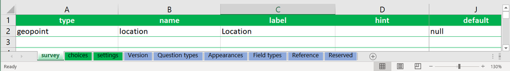

I suggest you add a geopoint question to your survey and set the default column to null.  If you do not want to display a map in your survey, also set the appearance to hidden. I hope that helps.
