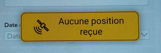

My users have reported that the Survey123 app keep showing the following error message when they try to complete a survey with no GPS signal on their Android devices:
Basicly, what it says in english is : "No position received"
The actual position of the user is not important for our Survey (The user select a location ID). So is there anyway to prevent Survey123 from trying to find the device position?

The Survey123 field app will always include a location in a submitted survey, even if the form does not contain a geopoint question. This is because the data is stored in a feature service, and each collected feature must have a geometry. If the user does not want to share their location then they just need to disable the device location sensor - this will result in a null geometry being collected.

The error message you are showing is a system error (that concerns location), not a location error (which is affected by the settings mentioned above).  The ability to disable that message is being evaluated; for reference, it has been filed as ENH-000124021.
