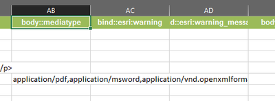

If I create a new Survey in the web and then open it in Survey123, I have a field "body::mediatype" to explicitly specify file types. However I don't have this same field available in the Advanced template.
