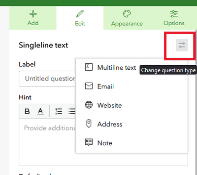

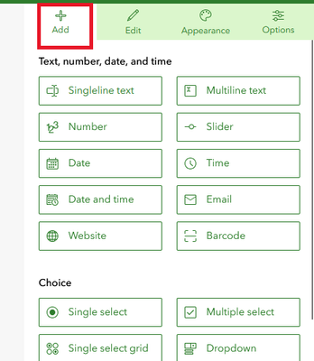

Regarding the web app, the only way to change a "data type" (e.g., change integer into string) is delete and re-add the question:
Regarding similar data types (e.g., single-line text and multi-line text) in the web app, you can use the "swap" button to swap between them. Just select your question, and then click "swap":

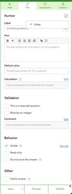

In the https://survey123.arcgis.com/ builder I can't find any way of changing the data type to decimal.

I don't believe "Decimal" exists in the web app? I'm not 100% on that since I don't use it often, but I don't recall seeing it there.
ibdj
No, that's what I tried to show with the screen shot; the decimal setting for data type does not exists in the web app.
