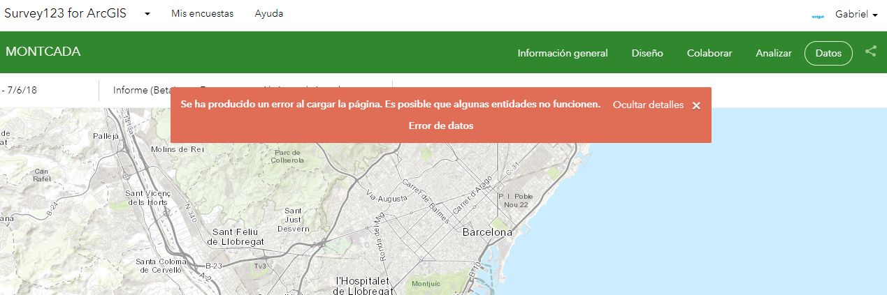

Hi everyone,
Does anybody know why (since yesterday) I have no access to my collected survey data? Is it a global error?
In the Data section says "An error has occurred. Some entities may not work."
It happens the same with any survey I have, and they were working perfectly before.
Thank you,
Gabriel

Hi Gabriel,
I have seen a few cases this week, and last week, where this issue has occured, and have experienced it myself.
The last thing I did yesterday was to clear my browser cache in Chrome, and that seem to make the issue go away, at least for now.
Haven't seen this issue in Microsoft Edge (but didn't do a lot of testing), but that browser have perhaps other issues.

Hi Gabriel,
Can you please check to see if you are able to see the data in the ArcGIS Online Map Viewer?  You can load the feature service in the Map Viewer by looking for the survey folder in your ArcGIS Online Content folder and choosing to 'Open in Map Viewer'.
If you cannot see the data here please let us know, and then try the method Sverker Norlander‌ mentioned, clearing the browser cache and trying again.

Hi Brandon and Sverker,
With Google Chrome the problema continues. Although, it works when I open "Open with the ArcGIS Online Map viewer" or with a web map including the feature service.
It also works if I open the Survey website with another navigator, i. e. I Explore.

Hi Gabriel
This also happened to myself.  The reason you cannot see the data is because the settings of the feature layers created from the survey.
In the settings of your feature layers check the section title "What features can editors see?"  Make sure you have "
Once you make sure your feature services can be seen it should work.  If you don't want the public to be able to see the data, you might make it so that "Editors can only see their own features (requires tracking)" is checked.
