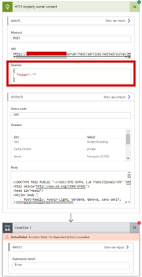

I am wondering if anyone using ArcGIS Enterprise 10.9.1 with Survey123 (not on-prem) are having issue with Power Automate is not able to get attachment based on fantastic tutorial here: (1) Survey123 attachmenrs in Microsoft Power Automate (esri.com)?

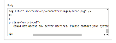

I did not get any token returned but got the following error: "Could not access any server machines. Please contact your system administrator."
We use local portal administration account with Survey123 (Custom Connector) since we are using Portal with S123.

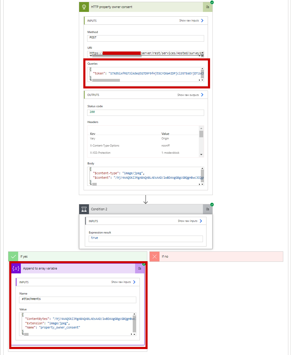

Previously

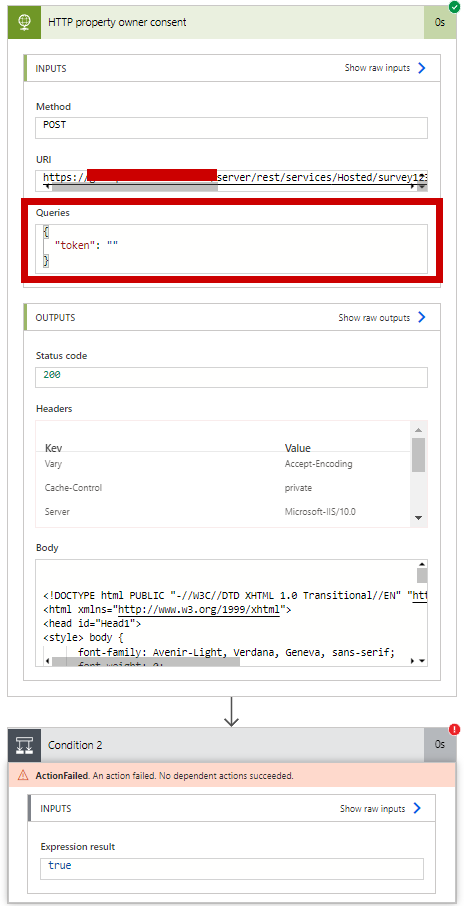

Currently
