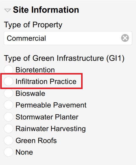

I have a Custom URL that brings over values from point features from web map to Survey123
arcgis-survey123://?itemID=48ef3616c0d443d0b1ca4d007d96df43&field:sw_id={SW_ID}&field:name_dev={Developmen}&field:sw_address={Address}&field:type_of_prop={Property_T}&field:GI1={Green_Infr}&field:Num_GI1={NumberofGI1}&field:GI2={TypeofGI2}&field:Num_GI2={NumberGI2}&field:GI3={TypeofGI3}&field:Num_GI3={NumberofGI3}&field:Detention_Fac={Detention_}&field:Num_Detention_Fac={NumDetnFac}
But when I make the field in Survey123 a Select One field type vs a text nothing gets populated.
select_one type_giGI1Type of Green Infrastructure (GI1)horizontal-compact
BUT, the questions that are dependent on value being written to GI1 field show up.
Therefore, some value is being populated to that field, but is not populating the Select One question.
Is there a way around this? What I need is the ability for Custom URL to work, but also if there is no value in that field the users of the form be able to select the value from a drop-down.

Try without setting any voice in appearance field ("horizontal-compact" as I can see).
I found a similar bug in the past: Populate select_one question with a value from asset

Are you passing in the value in Name or Label?  Need to use Name value.

Once I changed the appearance to minimal, it worked.This could be a bug.
