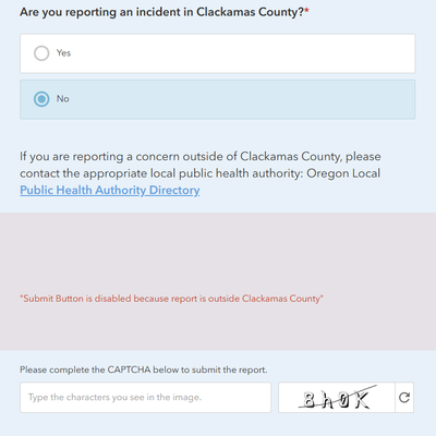

AaronPDXPaul
Hi @ZacharySutherby
Can you provide sample text that will modify the constraint message?
Where it changes the color, maybe makes bold, increase font size.
Also, the box for the message is light red, along with red text.
Can this box not be light red?
The image below sort of works.
But is not elegant and makes the user feel they've done something "wrong"
