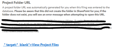

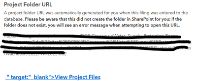

I have a Survey123 form, which I am designing in the latest version of Connect. The URL I am creating works perfectly in Connect when I test, but as soon as the form is published the web form (which I have embedded in a Dashboard) does not work. Please see details below.
I am having some issues with an a href statement working properly. It works perfectly in the field app and Connect (latest version downloaded today). Here is what I see in my form within a Dashboard; the blacked out portion is a read-only URL to SharePoint, while the hyperlink is in a 'note' and should say "View Project Files" and bring the user to the SharePoint location from above:
The URL is completely different than what is specified; it goes here instead: https://survey123.arcgis.com/share/v3.14/
I have tried the a href statement with a : and = after 'target' and get the same result. Here is the XLSForm:
Is this expected behavior? Any advice would be appreciated.

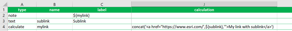

The trick is to create the complete HTML tag in a calculate question, and then bring that into your note label. For example:
Here is the calculation in plain text for clarity. Putting the quotes of the right type in the right place can be tricky. I typically make the calculate question a text question  for debugging, and when it is good to go I turn it into a calculate with esriFieldType set to null.
concat('<a href="https://www.esri.com/',${sublink},'">My link with sublink</a>')
concat('<a href="https://www.esri.com/',${sublink},'" target="_blank">My link with sublink</a>')

Thank you for that help - I was not quite doing it this way. I was trying to set up one field for my link (which is type=text, but appearance=calculation and then a concat statement in the calculate column to generate the URL from a base URL and then 3 different fields in the form) and then a note which has the a href in the "label" column. Adding an intermediate calculate question for 'mylink' with your example above worked perfectly.
My quotes were also a bit different from what you've shown, so seeing the second example was very helpful.
