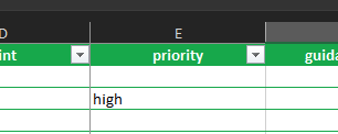

After reading this post , I see how a field could be added the HFS of the survey, however this would mean that I would have to manually add priorities to questions after a survey is submitted since the survey schema would not have this field built in. I've also built a test survey (xlsf attached) where I explored adding a priority column to the workbook, however when published there is no means to call on this column (expected, but still wanted to test). In the test survey, you can also see how assigning a priority to each question creates a new priority field, when a single priority field that spans all questions is desired.

Adding a column here won't add anything to your Feature Layer (and may negatively impact your survey). I would not recommend doing this.
Adding a row here will add a corresponding column to your Feature Layer. This is the indented workflow.
You need to determine how an item's priority is set. Typically, you would use some type of logic in the form. E.g.,
  • Your ${example_priority} field could allow the user to select priority manually (that kind of looks like what it is already doing). You could use this manual priority in you web map/dashboard; or
  • A calculate could be used to automatically generate a priority based on previous inputs. maybe something like
