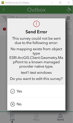

Hi again @SkylerKasko,
Also note that if you are trying to submit via the Survey123 field app (using your test survey example), you should get an error, and the upload of data should not be successful, as there is no geomtry on the table. I see the following when trying to submit in 3.11 or 3.12 beta field app:
If you are not seeing this error and submissions were successful, just checking are you using the web app to submit?

I did not get that Send Error when testing the full survey I am working on. When I initially created the Geopoint_Test example survey, I did see the Send Error pictured. However, in testing I switched the order of the two questions, republished, and then switched the order back to what it had been originally, and republished again. At that point I no longer saw the Send Error, and the submissions were successful, with a feature created at the coordinates captured by null_geopoint. I am using the field app to submit, not the web app.
