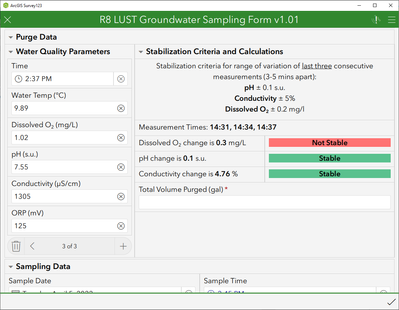

I was in the same boat as you looking for a solution for groundwater sampling. I've developed something using javascript to do the stability calculations on the repeat values. I only have calculations for pH, conductivity, and dissolved O2 but more could be added. I've attached the xls form and the javascript file to add to your 'scripts' folder in your survey.
