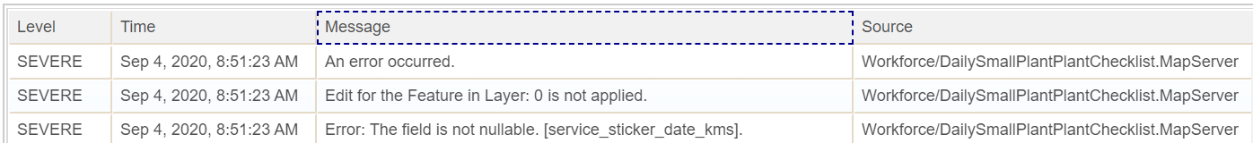

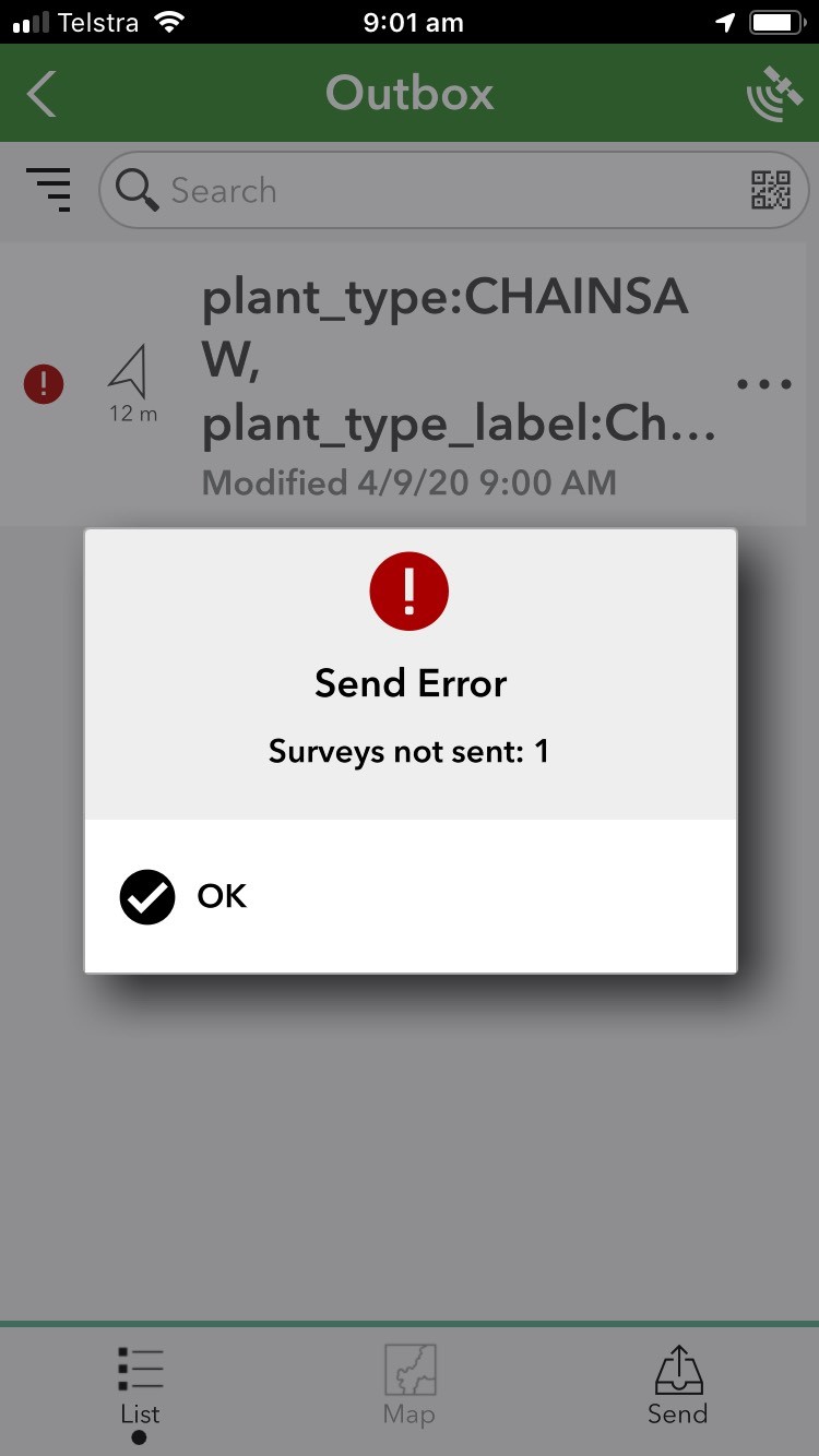

I publish the survey and it all works as it should except when I send the completed form to our portal. The first time I send it, it gives an error - see screen cap below. The error in the ArcGIS Server Manager is also shown below.
Survey123 send error
The strange thing is if I go to the Survey123 outbox, edit the form again, don't change anything but just send it, it works the 2nd time around. This behaviour is consistent. As well, the surveys in the Survey123 outbox won't send if you click the Send icon at the bottom of the outbox - it gives the same error as shown above..

Also, with the above error screenshot, if you select OK and then select the red error icon on the survey record in the Outbox, you should get a detailed error message. Can you provide that information if possible?
From the server error message, it looks like you have field in the feature layer that is not nullable, however you are trying to submit a null value to it. When you open the survey from Outbox again, it may be changing the null value to a blank ("") value which are treated differently by the server.

The error messages from the app and ArcGIS Manager are also shown below.
