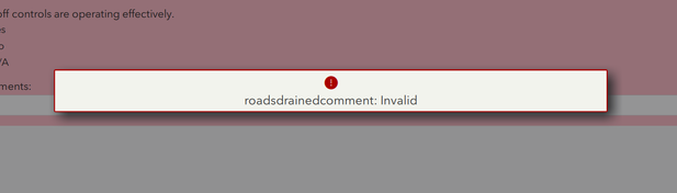

Ah sorry. Misunderstood. If the lack of a visible field to highlight highlight red is the issue, you can apply a constraint to a calculate as well. So converting the hidden text field into a calculate should work. I do this whenever I need to apply a constraint to a repeat. The constraint will work and the constraint popup will appear, but since it isn't tied to any physical point in the survey (like a text field), it may be confusing for users depending on how you have it set up.

Wow calculate does work differently now.  It does a popup box in connect, not sure in the web or app.  This must be new.  It does seem like it would confuse the user though because it gives the name vs the label and that field is no where to be found.  I wonder if this popup will be added to hidden and visible.
