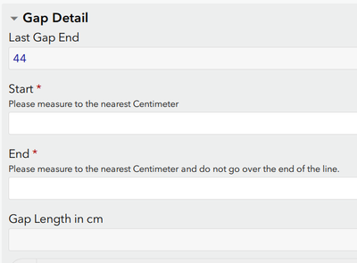

For my gap if you are going down the line I just check max().  No need to go to the last repeat since the max is always in order.

Well we show them the last gap since it is not automatic that the end will be the new start.  We check against the last to make sure the new start is more than 2 cm past the last one.
In your case for the first one a if should do it.  if(position(..) = 1, 0, max(gapend))

great question.  For now (or at least until I can code a better solution), I am just adding start_gap2, start_gap3, until I've reached a number beyond what we might expect (10 gaps along a 1,000 cm line?).
That said, I can vary the number of gaps that show on the tool by putting some constraints and relevants to reveal the next entry field (or not). The end_gap of the previous record must be smaller than the next start_gap. After entering an end_gap, a new start_gap (start_gapn) will appear unless the "relevant" condition for start_gapn is ${end_gap} <= 9980 is not met.  (The 9980 represents 20 cm prior to the end of the line; 20 cm being the minimum gap size.)  But the last gap may come well before that in which case the user will leave start_gapn blank.  Usign the repeats, I was able to get the Previous End Gap to display, but (back to the original problem) the first value was Null and that was violating my constraint on the start_gap: ${start_gap}<=9980 and (${start_gap}> ${prev_end_gap} or ISNULL(${prev_end_gap}).  The ISNULL didn't work.
