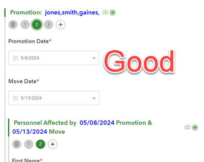

All of my users will be using the web version of the survey. I built it in connect to take advantage of repeats. The behavior works perfectly in connect, but in the web it's not working correctly.

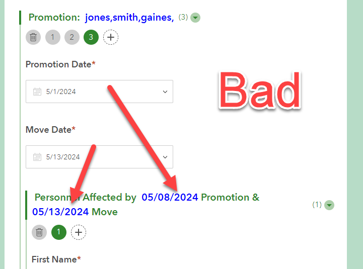

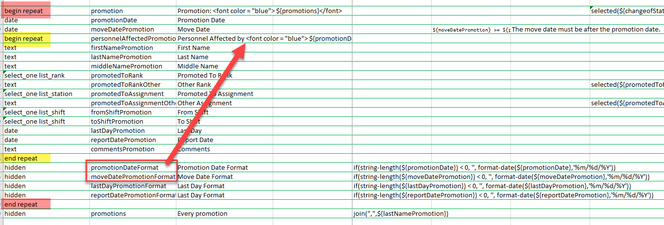

I have a repeat within a repeat, and I have the parent repeat fields within a label of my child repeat, they are coming from a hidden field that I've calculated to format the date properly. If I add one parent repeat and one child repeat, I can create another parent repeat with the correct dates populating. If I add one parent repeat and two child repeats, when I create another parent repeat the dates are no longer pointing to the most recent parent repeat.
I have attached my xlsx form.
RobertAnderson3
MVP Regular Contributor
You might need to look into using the position(..) function to make sure it's querying the right one. If you don't specify I believe it just looks at the first repeat position.
There's some more info to be found here: Repeats—ArcGIS Survey123 | Documentation
